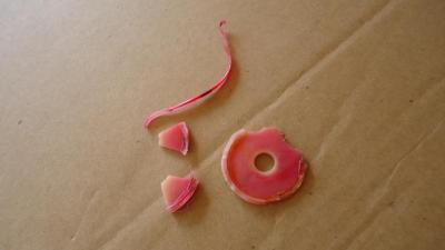

Hey guys, bad news for me, I think my transmission just went out. 1997 Boxster 2.5 Trip. Gears were slipping, turned around and went home (4-6mins), got there just in time to get no traction in gear, and dump a load of oil. Pic attched is of the belly, and the pink 'think' that was in the oil. Does anyone recognise this part, I haven't called the garage yet, but I am guessing this is a total transmissioon failure. Anyone have any advice?

Man that sucks, I don't think the orange thing came from your car. have you had oil leaks before or is this new? It could be you shift cables on the right side of the transmission may have come loose or off and that will prevent you from gettin completely in gear. At least for your sake I hope that's what it is. Otherwise you will have to get it rebuilt or buy a used one from ladismantlers or craigs list. good luck and let us know what you found. Good luck

P.S. the oil you see in the photo, is but a fraction of the wound! That was after the clean-up :-(
