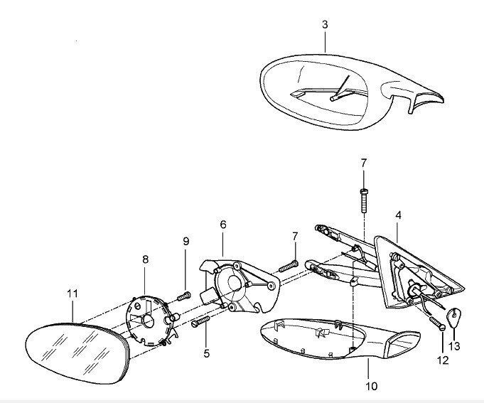

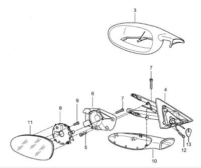

Is this the instructions for removing the side mirror?
Just unclip the mirror and disconnect the heating wires. You will see 3 Torx screws which hold the shell on to the mirror mounting frame. Undo them, and swivel the unit towards the door. Then you can unclip the bottom plastic cover, and slide the shell over the mirror mounting frame. It's all very easy and fairly obvious once you have taken the mirror off.
These came from the 996 forum.
Paul
987/997 are different, the shell consist of 2 separate parts, the glass must be removed first, they are a little more tricky to remove from the mirror chassis. Ask Loren for a exploded view.
