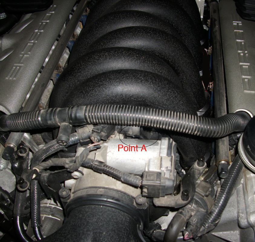

Hello All,
I was about to do some general engine inspections today that surprisingly notices a light smoke (not sure blue or white, but I think more of a blue color) was coming out from beneath the plastic cover that has the "4.5 V8" logo on it... from under the throttle body. it was like you leave a cigarette under this plastic cover and it finds its way out...
I removed the plastic cover and didn't see any leak at all, every where seemed to be dry. the crankcase vent lines are all in good shape too, no crack or leak...
after a minute the smoke was gone. I turned the car on again for 10 minutes and whatever I did no more smoke appeared.
Is there any other pipe than the Crankcase Vents that passes in that area, specially under the throttle body and could leak over a hot part of the engine? Might that be a coolant leak? any coolant pipe there? (in the attached photo, smoke was coming out of the circle named point A)
Thanks for your help.

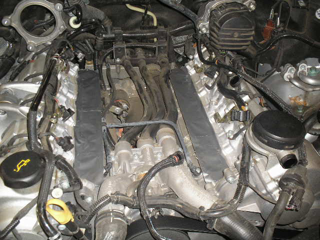

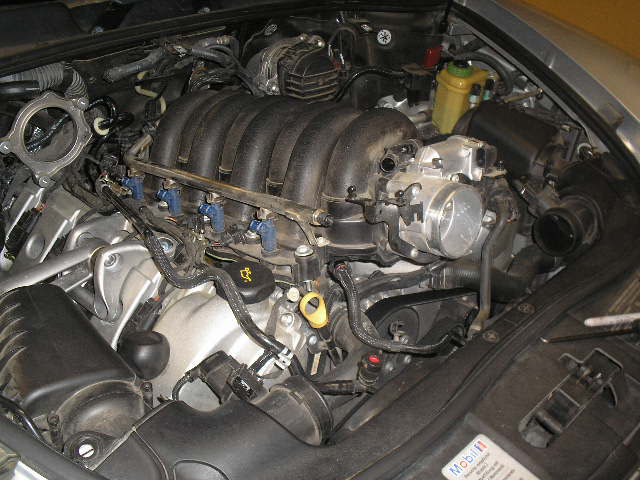

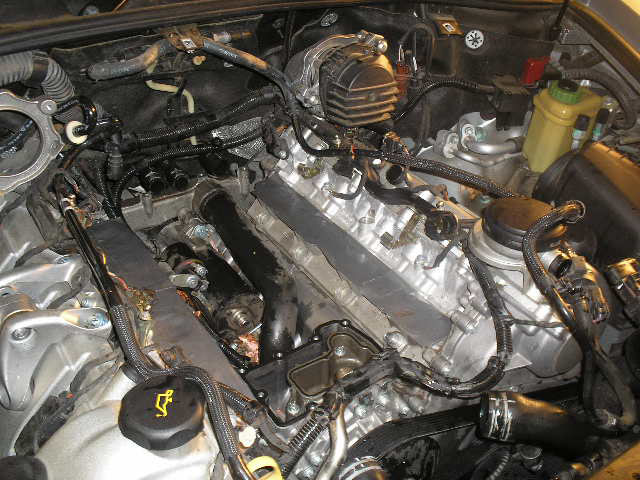

To have helped others like me to understand what and where exactly are these bypass cooling pipes, I have attached few photos.
This operation nearly opens every part and gives access to many things to be replaced at this point and saves Labor cost... I heard that there are 2 hoses at the back of the engine that needs to be replaced too, because they fail and leak too... Could that be the time to have Water Pump replaced/repaired or Serpentine Belt perhaps be replaced to save labor cost in future?
If this happens due to the burst of pipes, coolant fluid pour down over the Torque Converter Seal and brings about another 2K cost in short run. Could replacing these Pipes before burst be done so careful that no coolant pour down over the Torque Converter Seal? What about replacing the hoses at the back of the engine?
Thank you for your time.
post-63813-0-08117400-1297304860_thumb.j
post-63813-0-53618000-1297304870_thumb.j
post-63813-0-14591500-1297304877_thumb.j
post-63813-0-61475800-1297304887_thumb.j
post-63813-0-71152500-1297304898_thumb.j
The 2 hoses and plastic connectors on the back of the engine should have been replaced together with the the 3plastic pipes in the middle of the V for better access. The allu. pipes, and of course, the older plastic pipes can also leak where they are connected to the thermostat housing. The small and brittle black plastic pipes connected to the left and right cylinder head (visible above the allu.pipes in the pic., are also a source of problems.) With the allu. pipes installed, there are no longer major leaks in that area which can cause damage. Cayenne V8 and Turbo till MY06. MY08 DFI engines have an other design but are still made of plastic.

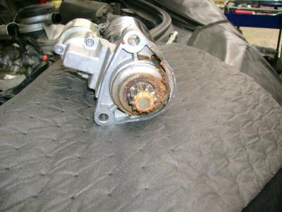

Dear friends, should I replace the starter or not?
Also, do you think the leak which has found its way down into the starter hole and over flywheel, etc. could have already damaged the Torque Converter Seal?
My service advise is totally negative on this and he believes any fluid getting in there would never damage torque converter because it is sealed. He say they do not have any of previous customers who did this job returning in few months for Torque converter seal issue. Your opinion/experiences would be appreciated.

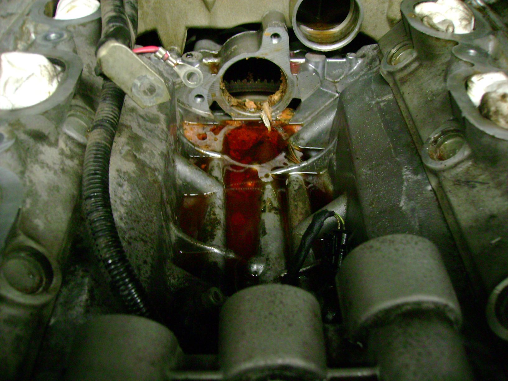

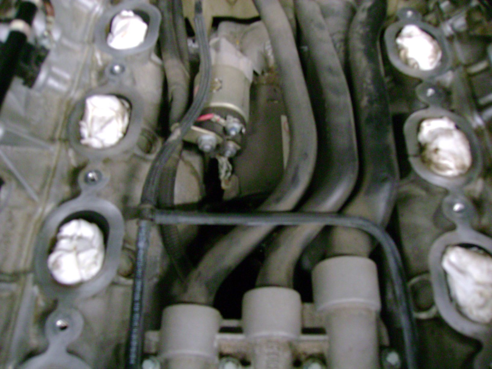

Now: more update on this leak issue:
So the coolant was really Orange in color and the 2 icicles formed under bell housing was from the coolant drips. It is interesting to see what I thought to be a gradual leak (I mean 1 liter coolant loss in reservoir every 2,000 miles and not a sudden loss / pipe burst) could have gone this far... See photos of the starter and how the coolant has formed around the area...
post-63813-0-50573800-1298602296_thumb.j
post-63813-0-44236200-1298602324_thumb.j
post-63813-0-93095100-1298602423_thumb.j
post-63813-0-83786500-1298602511_thumb.j
How much is the starter to replace? Looking at the photo it is clear that coolant was able to get into the starter, how long it will last is another question. Typically the bushings etc are a non factor as far as wear items in a starter, the solenoid was high enough to be out of the problem. If it was me and I intended on keeping the vehicle for an extended period and the price was reasonable I would change out the starter now while it's easy to get at. My service records from previous owners showed my input seal had to be done just after this leak occured ($9000.00 + warranty repair bill!) So the advisors saying this can't happen is false, there are a lot of owners out there that have had input seal failure resultant from coolant pipes bursting/leaking.
Thanks for the replies, I am very much happy to hear there are people out there who have been through pipe upgrade process BUT not seen the Torque Converter Seal failure just after pipes break... that gives some hope...
Back to starter, Yes I made the decision to pay for a new one, it was expensive ($709). I could not wait and see one of these days my starter fails and have to dismantle all the parts again to reach the starter... so although money was an issue but between "bad" and "worse" i chose "bad".
