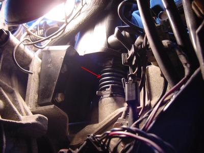

Are you sure it's the O-ring that you see protruding outward? There are two raised bosses on the engine case at the point where the two 10mm bolts are inserted into the block and that may be what you are seeing.
Here are two photos that show you the raised bosses, with and without the AOS installed. Be sure to check that the bellows (red arrow) is seated properly, as that is usually the area that gives everyone some headaches in the install.

Looking from underneath the right rear wheel well, you can see that the face of the AOS housing is not completely flush with the engine block because of the two raised bosses. Good view of the bellows and how it should be seated squarely and flush down onto its tube. (Note that the lower of the two 10mm bolts has not been tightened yet in this photo).

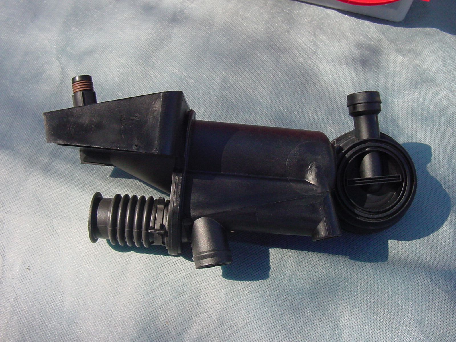

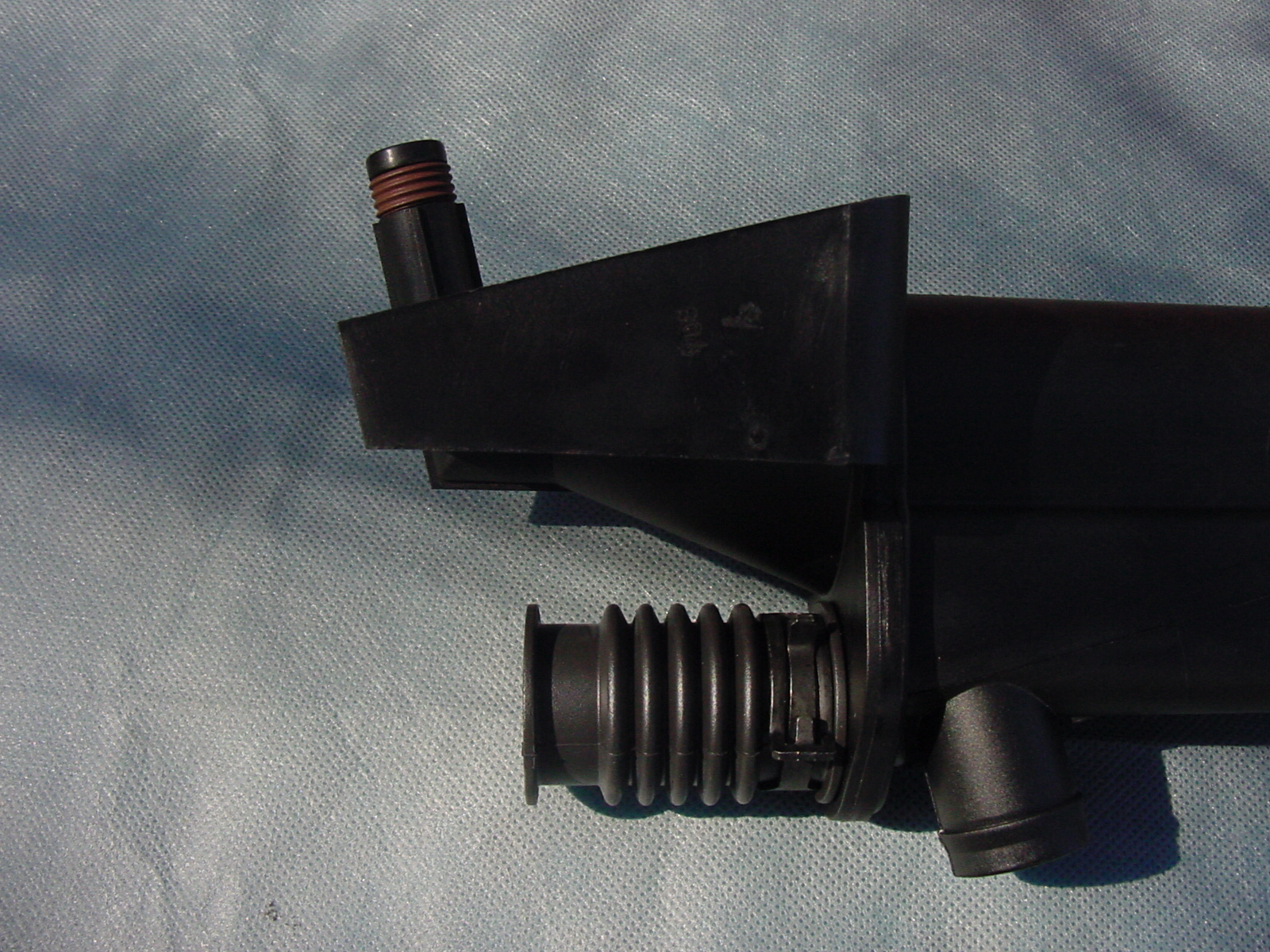

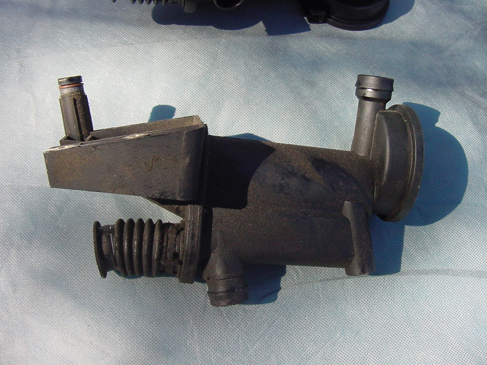

Note that there is a difference in the width/design of the seal in question depending on the version of the AOS.
These photos can help to clarify the difference (click on the first one to blow it up):
post-6627-0-96905500-1297930673_thumb.jp
Old Version
post-6627-0-36774700-1297930695_thumb.jp
Newer Version
post-6627-0-74469500-1297930706_thumb.jp
Newer Version Closeup
I think from your photo you have the latest version of AOS. The smoke is not coming from that o-ring seal. If its not sealing correctly you will see oil leaking in that area. No leaking oil than the seal is ok..
Some cars tend to smoke on start up even with good operating AOS systems. But cleaning your intake tubes and TB is a good idea as residual oil can be trapped...
