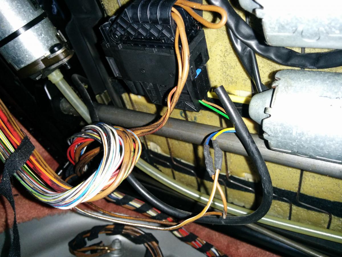

Is it possible to determine if the repair kit has already been installed? Car is a '99 Carrera. My airbag light is being triggered by the driver's side seat buckle. The image below is the end of the buckle connector under my driver's seat. The wires have clearly been spliced, and to remove the seat completely from the car, I would need to cut the blue and yellow shrink-wrapped wires. Those splices bypass the connector and go directly into the loom.
First step is to order some of the DeOxit spray and give everything a good cleaning, but if that fails, do I need a new seatbelt buckle, or the buckle and the repair kit?
Currently the light is off, as a local shop did the read/reset for me. And it has remained off for a few trips since then, though I don't want to drive too much until this is resolved.
Thanks!

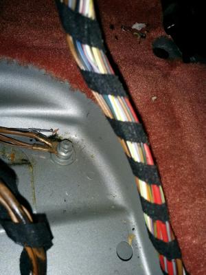

If the additional grounds have already been done then it comes back to the seat belt buckle. If the TSB has not been done - then it should be. PM me if you need instructions.
Some have cleaned the belt contacts and gotten a couple more years out of them but eventually they will wear out and need replacement.
 Thanks for the reply. I've attached a picture of the ground connection; due the extra wires, can we presume that the TSB has already been completed? If it matters, I have the standard seats with memory seat option but no heat.
