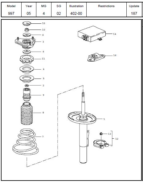

Old post BUT there was a tech bulletin about this, 4075.  The spring top is not shaped correctly and sits wrongly, contacting the spring plate and/or the stop plate (6 and /or 4).  Fix is new springs: for the coupe, C2S manual, they are 997 343 531 42 504
