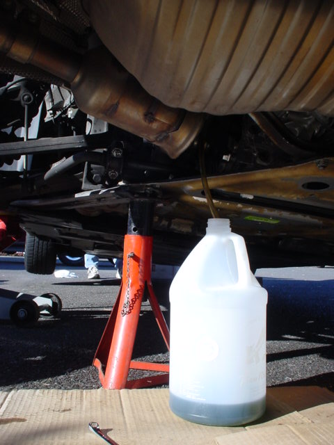

I do this at the same time we do a brake bleed. I use the Motive.
After I have bled the left rear brake caliper I release the pressure from the Motive. First, remove the rubber cap for the clutch bleed nipple. I then crack open the clutch bleed nipple from behind and from the drivers side where the exhaust is. I use a deep socket on a 1/4" drive ratchet to crack open the bleed nipple. From my memory it is 11 mm but some cars car 9 mm. You can also use a normal box end 11 or 9 mm wrench if you have a very small one, as it is hard to swing the wrench due to the confined area. That is why I like to use a ratchet wrench.
I then remove the 1/4" drive ratchet and leave the socket on the nipple. Close the nipple with your fingers on the socket and put the drain tube on the nipple while you are under there. The nipple should be just finger tight.
Pump up the Motive and then open the nipple with your fingers. When enough fluid has come out of the tube close the nipple with your fingers and disconnect the Motive. Tighten the bleed nipple with whatever tool you are using and put the rubber cap on while you are under there.
If you are doing the brakes at the same time then you pump up the Motive and do the front calipers.
