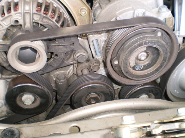

Anyone change the idler pulleys on a 996 GT3? The nuts are blocked by a metal frame. How is this removed?
Are you talking about the one on the right? Offset box end wrench
Left=Idler center=tensioner right=idler
Thanks. These are very helpful.
How do you get the torque wrench to fit? Do you use an adapter?

Did you manage to replace the idler on the right of the tensioner (below the air con pulley) without removing the engine carrier? Someone on the 996 turbo forum found the bolt was just a bit too long and was stopped by the engine carrier and couldn't remove it after undoing it. i need to replace mine but am trying to work out how much time I need to budget in case I need to remove the engine carrier or drop the engine slightly to do it.
