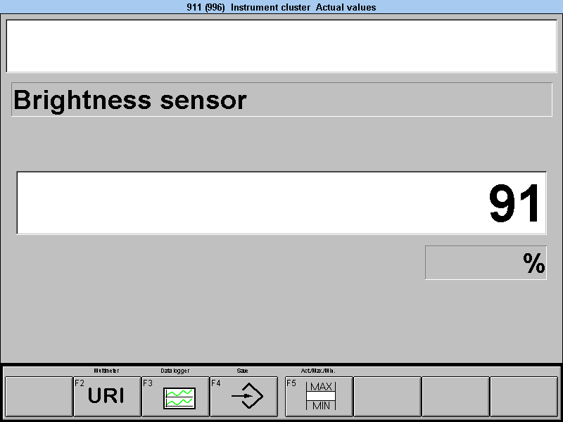

The sensor can be tested with Durametric, PST2, or PWIIS tester.
Left - Dark (sensor covered) -- Right - Light (sensor with flashlight on it)

Thanks for the tip! I had already run through headlight switch functions, under the same suspicion you suggest. All lamps function as they should. If the instrument light ambient light sensor is the issue, can it be replaced? (I've seen on 911 and Boxster forums how expensive instrument cluster replacement can be!) - 2seatcollector
