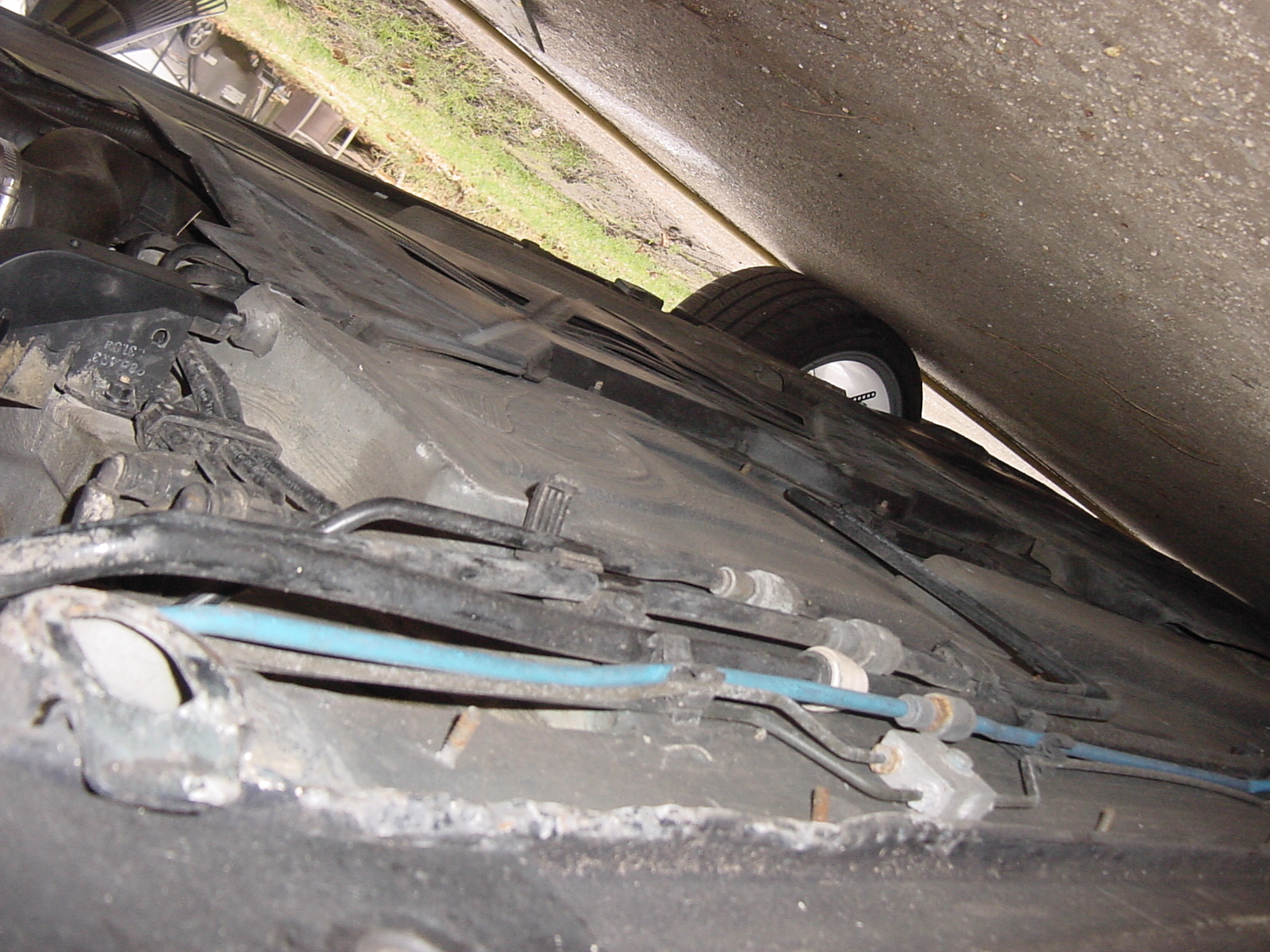

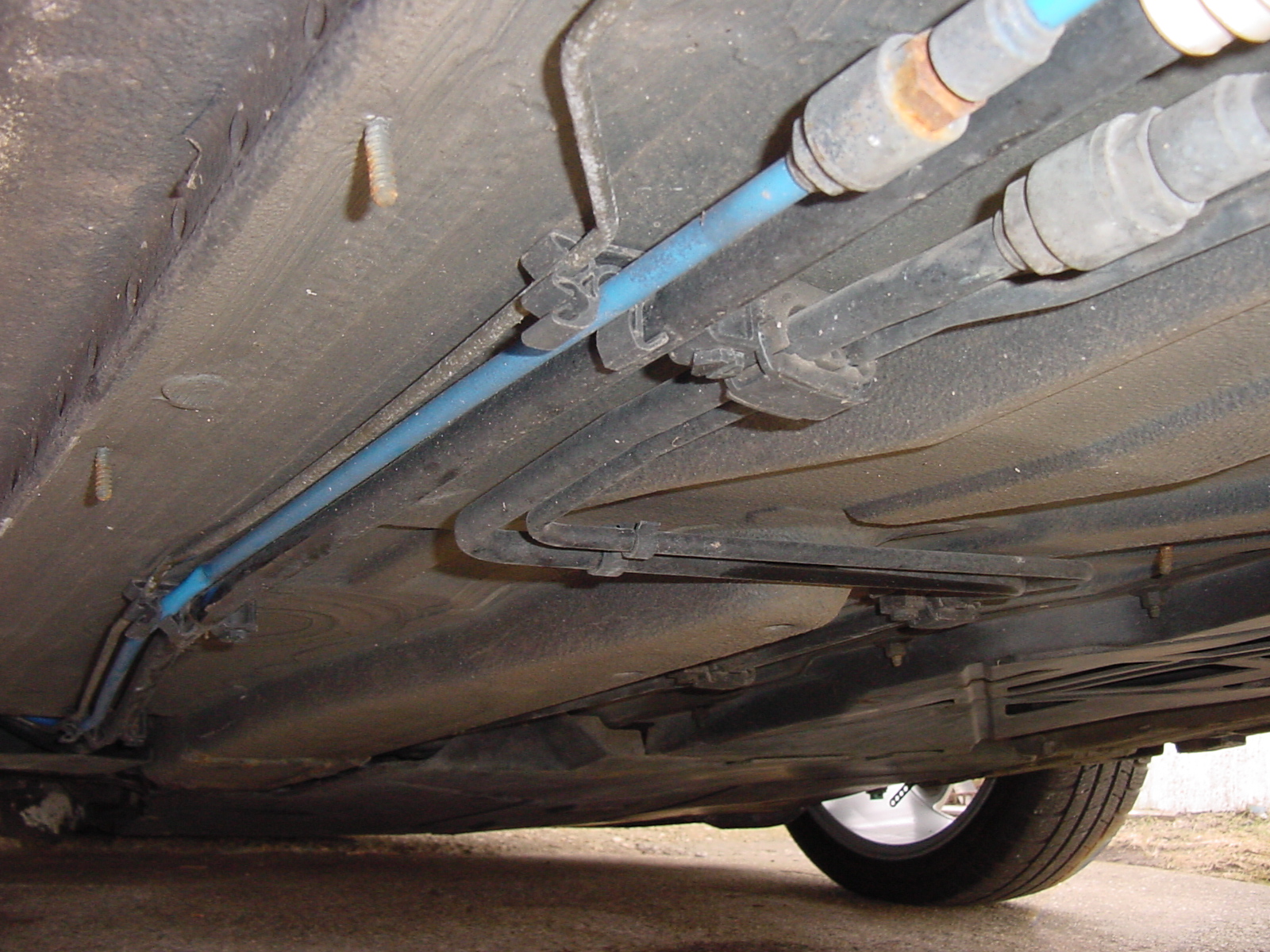

One of the places that you have to be very careful is along both sides of the car, just inboard of the rocker panels/door sills, as the brake lines, power steering line and clutch line run along the left side and the a/c lines fuel lines run along the right side. Under the center longitudinal line run the radiator hoses and there are two lines that run from under the left rocker panel towards the center not far from the middle of the car's underbody. Nonetheless, don't drill anything without having a look underneath for yourself and, if you are going to go that route, be sure to rust-proof the circumference of the newly-drilled hole.
Here are a couple of photos of the underbody so that you can orient yourself:
post-6627-0-43896400-1304651585_thumb.jp
Looking forward from driver's side rear
post-6627-0-70137400-1304651541_thumb.jp
post-6627-0-24759600-1304651600_thumb.jp
Looking forward from passenger's side rear
Also, note that these are from a 986, but I believe the 987 is similar.
Regards, Maurice.

Maurice,
You've been an amazing amount of help to me with this issue. The underside views were very helpful.
I managed to borrow a floor jack and lift the driver's side of the car. Upon removal of the underpanel, I was able to easily drill two 3/8" holes in the low spots of the floor without risk of puncturing anything important. I siliconed in two grommets to protect and waterproof the holes, and put some mesh over the top to prevent the foam from forming a seal on the grommets. Now if any water does leak in, it will hopefully be able to drain out.
