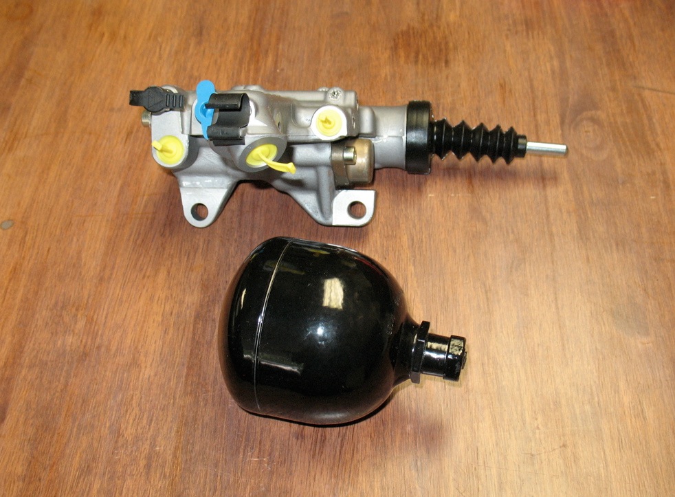

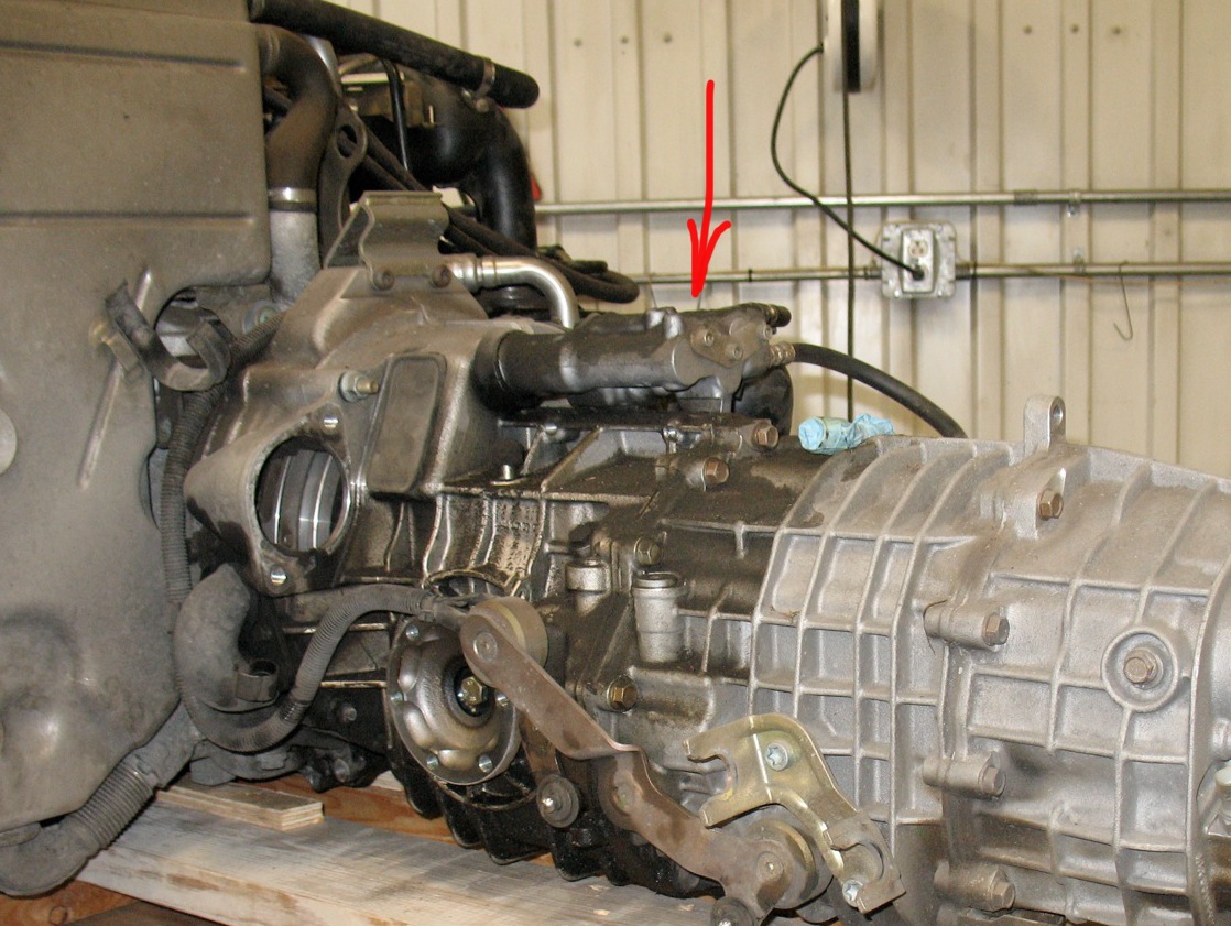

There was some case in the past were the clutch fork was broken. One way to see it, is to remove the starter and with a mirror there is a possibility to see a little bit of the fork movement. Also a slave cylinder failure is possible especially if there was no oil in the clutch reservoir..... The top part on the first picture and the location of the slave on the second picture... Remember the steering pump pressure is used for the clutch operation. Take a look at you steering reservoir to see if the level is normal.
