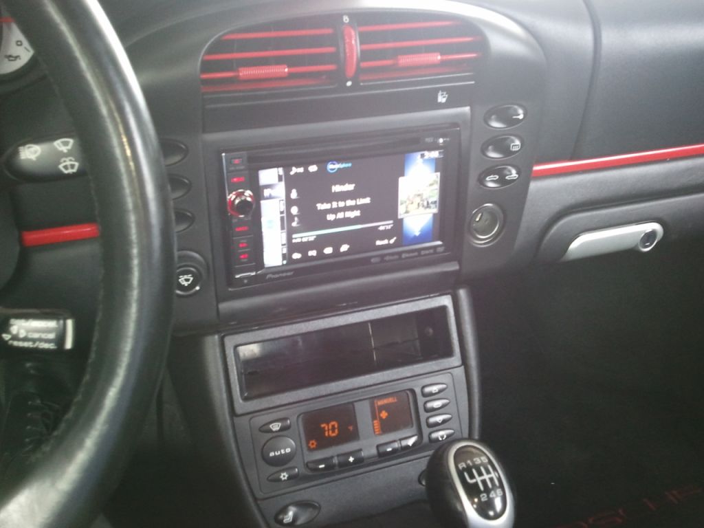

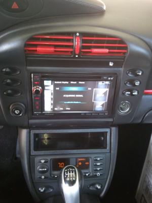

I added a Pioneer AVIC-x930bt ($850 online) to my 03 996 Cab. Nav, iPod Dock, CD, DVD, Sirius tuner, and Bluetooth. Looks and works great and the bluetooth pairs easily with my Droid for phone and audio (like Pandora). Also has the color change option and the start up (flash page) can be customized (I used a very cool stylized image of the Porsche Logo). Watch the installation costs since the subwoofers in the 911 run off fiber optics so you will likely need to add and amp to run those separately. Note, when they took out the original deck, I had them make that into a "Pocket" so I now have a place for my phone/sunglasses, etc. I also have the original in the garage, just in case!

Of course, the cutout in the dash had to be modified to fit the new deck, but the AC controls and new pocket fit easily in the slots where the old CD holders and stereo were. The wiring just followed. Note that the AC controls are at the lowest point on the dash since that component is not as wide (and the dash narrows at the bottom). I decided this would minimize the customization and keep things as "natural" looking as possilble. Since the pocket could be any size I wanted, that wasn't an issue.
As noted, when adding the new deck the existing subs would not work with the new unit due to the fiber optic connections of an 03 996, so I had to add a separate amp to run the subs. This added about $1000 to the project. The acutal nav system is mounted under the passenger seat and the new amp is mounted in the boot. Except for the subs, I did add all new speakers but kept the original speaker grilles to maintain the original look of the car. It all looks and sounds great, plus, since I have a 6-spd, the audio is so much easier to operate now that it is not behind the stick.
