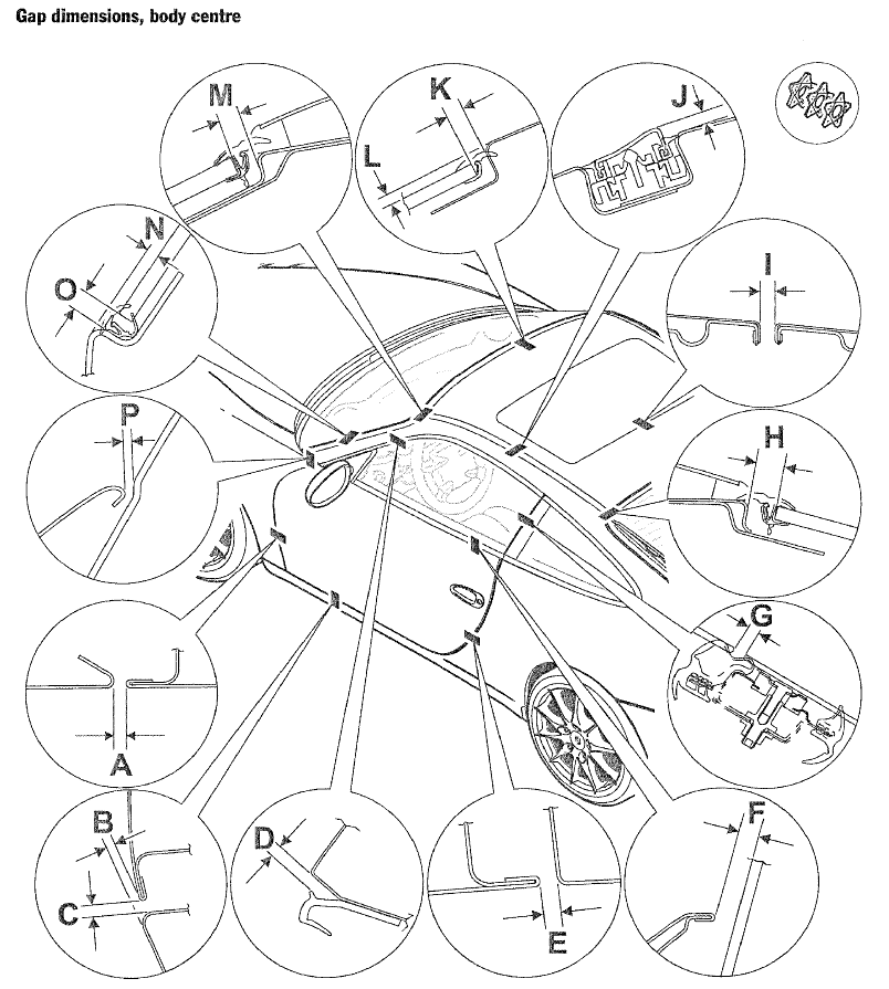

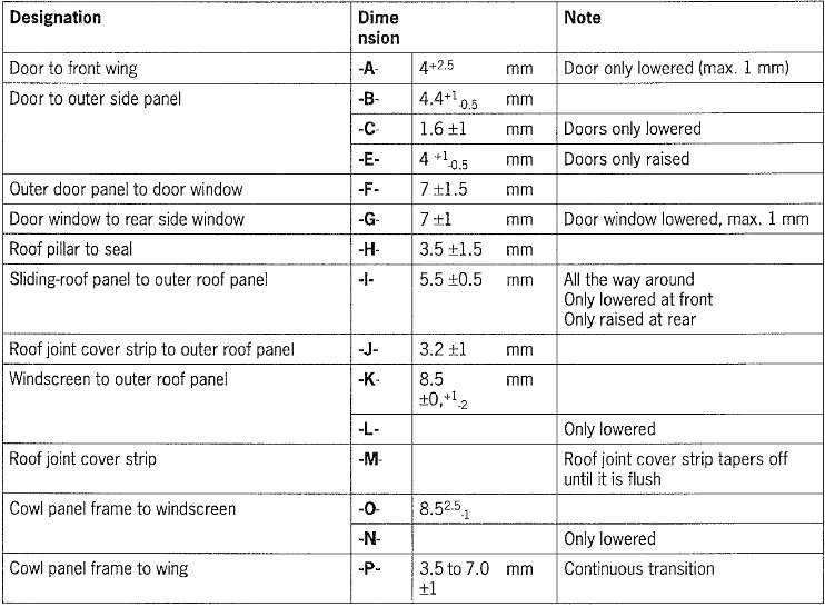

Body gap dimensions for MY2002 and newer
Setting the door
Setting the door at front
Undo fastening screw 1. Set the contour in relation to the wing and the side member by shifting the angle pieces 3 in their vertical and horizontal positions. (see body gap dimensions)
The setting range can be extended by removing the centering sleeve 2. Tightening torque: 17 ftlb.
Setting the door at rear
Undo fastening screw 4. Set the contour in relation to the rear wing and the side member by shifting the latch striker 5 in its vertical and horizontal position. (see body gap dimensions)
