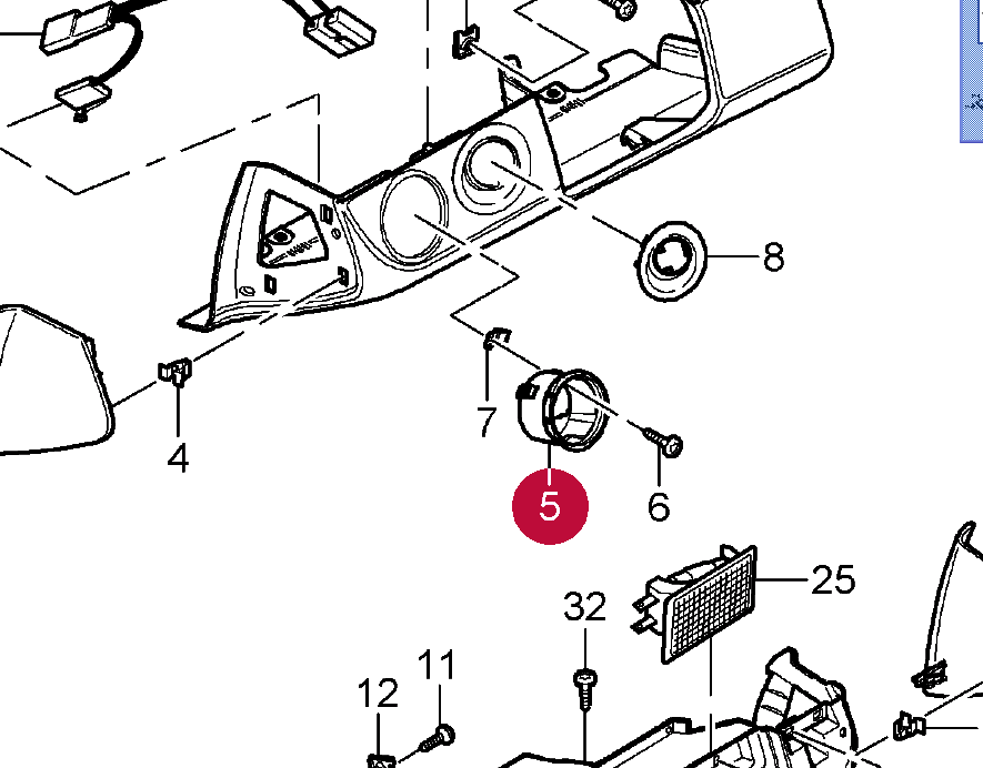

- The light switch surround which is a circular piece about 3-4mm thick that goes around the switch assembly on the right side of the steering wheel on the dash (just the outer surround)

Change out is pretty much as shown.
For the headlight surround remove the knob and then the screw inside the surround. I think this has been covered here before.
997.552.427.01.A03 Headlight knob trim -- US MSRP $16.93
