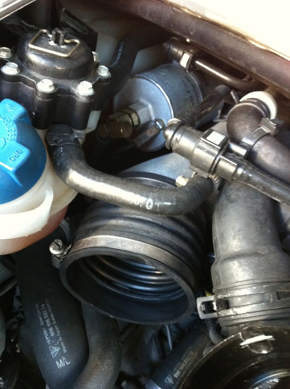

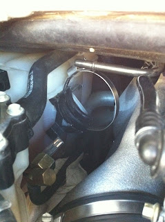

4) now the difficult part: it says 'remove the fuel filter with holder', 'to do this bend the retaining clip upwards as shown where the arrow is'. The arrow points to the top of the fuel filter - where of course no clip can be found. Space is very tight so you cannot do a lot of searching with your hand. I used a borescope to look underneath but couldn't figure a way to work this thing. So I ended up with a wrench with extender, flexible part up front with a screw driver end and completely loosened the restraining strap and pulled the fuel filter out with a mole grips (the fuel line in the back is so strong I couldn't pull it out by hand). I then could see the following picture below the the easy to remove holder (the rectangular front piece). I have no clue how I should have removed it with my big hands....if you have kids, give them a try.

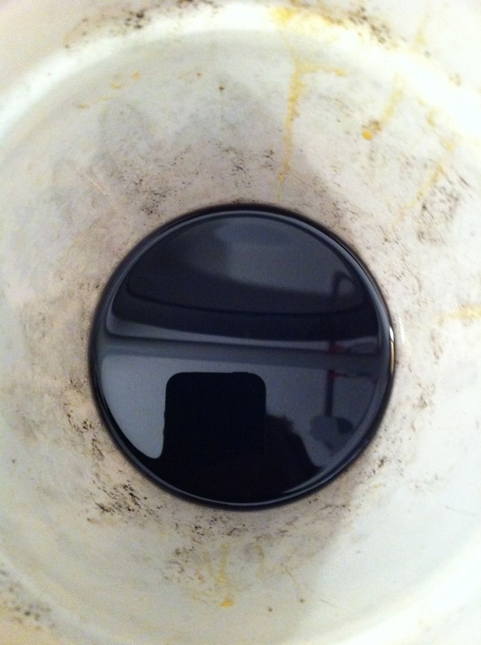

6) The picture below shows the fuel I have removed from the old filter...all black and dirty, not good. So if you have symptoms like I had, try replacing the fuel filter earlier than maintenance schedule.
