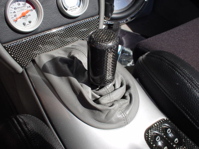

If you want to use the oem shift then I guess you can grind the flat blade to the proper size while it is in the car. If I was doing this I would remove the shift tower assembly and then take it to a grinder. I assume Momo uses a set screw.
If you are going with a B&M then you would grind it before you install it.

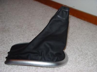

You can buy the horseshoe trim boot from Gert and attach it to the Momo shift. Or you can use the oem boot. This is what Danny did in the middle picture - except he has a B&M and also cut down the shift lever.
If you have the standard shift knob then you will have to cut the boot off and reuse it.
Hey TP this is Danny....man seems as though you post pics of my car everywhere!
As far as the friding goes....I actualy opted to grind down the inside of the shift knob instead of the shifter incase I wanted to go back to stock some day.....which wont happen. LOL
Thanks for the info ToolPants. I actually saw this pic of Danny's car somewhere on the internet, I think you posted it on Rennlist. Therefore, I knew it was possible. Danny thanks for your input as well. How did you actually do the grinding of the inside of the shift knob? Was it fairly simple? I think I want to go this route. I may go back to stock one day, or need to when selling the car.
It takes some time and dedication and definitely a steady hand.
The first Momo knob I retrofitted I actually just used a dremel and grinded it down.
The second knob was a full stainless steel knob which looked like it would be a little harder so I took it to my machine shop and milled it out.
Please let me know if you have any further questions.
