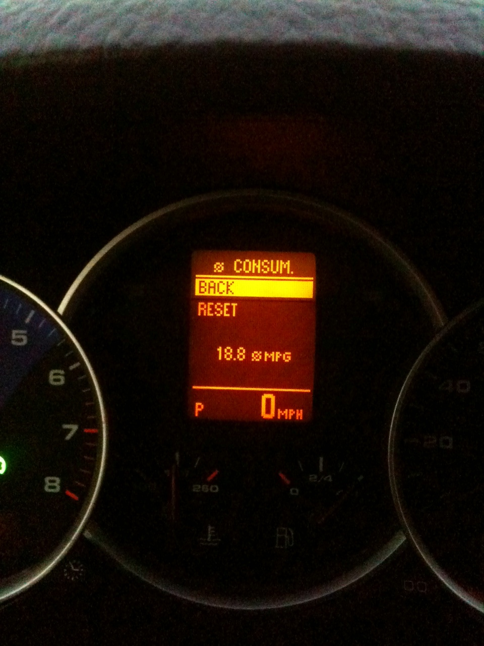

Greetings Cayenne-mates,
I'd been experimenting with a few styles of driving on an 2006 S, and I find that, while the actual gasoline consumed (as indicated by the miles drives/gallons filled) hovers around 15.8-16.5 (with almost 50/50 Highway/City relaxed driving), the computer (as indicated by the Main Menu>Vehicle Info>Consum) seems to quoting 18.5-19 (as in attached).
I usually fill up x gallons and compare the calculations - is this why? Should a few full tanks be driven, before they both will coincide?
I've never owned a car with a computer that can show mpg, hence curious on the discrepancy here.
Any ideas?

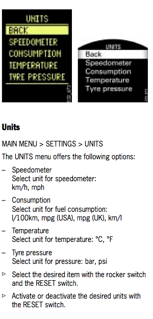

shyster77 -- double-check your vehicle settings -- the difference you're noting almost matches the volume difference between US gallon and UK imperial gallons as it relates to miles travelled/efficiency/consumption.
Cayenne's (and Porsche in general) tie GPS (if nav eqiuipped) to physical odometer and are usually quite accurate -- they may slightly err on showing more efficiency then reality but not as much as you are seeing.
Below from an '04 Cayenne S owner's manual shows you how to confirm the setting:
post-41432-0-33142800-1319496766_thumb.p
Edited by odix
Good point, odix. I just checked the Units for Consumption and it is checked for MPG (US). What is interesting is that the Consumption was showing to be 17.8mpg when I refilled and the actual consumed was 16.31mpg, i.e. the difference is getting closer than, what it showed before at 18.8-19mpg for the consumption, even though the actual remains almost consistent.
