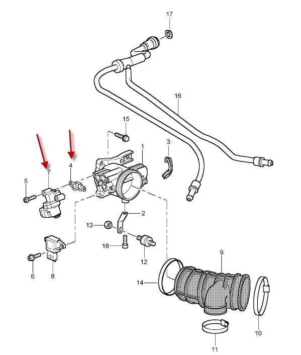

ICV = Idle Control Valve
Your car has one and it is likely gummed up and/or not functioning properly.
You can try and clean it with fuel injector/carburetor cleaner but it may end up having to be replaced.
There is a vane inside the ICV that turns to allow different amount of air in at idle. This vane should turn freely. You can test off the car with a 12 VDC source to the solenoid.
I would start with a through cleaning of the valve (be careful with the paper gasket item 7 and it can be reused). While you are there clean the throttle body well including behind the butterfly.
If that does not work then you will likely need a new ICV (item 7).
You can clean it without opening, but you have to remove it from the throttle body (careful not to damage the paper gasket, but it is cheap to replace if you do).
Some people have gone a "step further" and pressed out the pin and dismantled it to clean it, but I don't think that is necessary.

The IACV is operated by electromagnet. You can safely spray carburetor cleaner or equivalent inside the ICV and use a towel or rags to clean out.. Be sure that it drys completely before reinstalling. You really do not need to open it up to clean it well.
