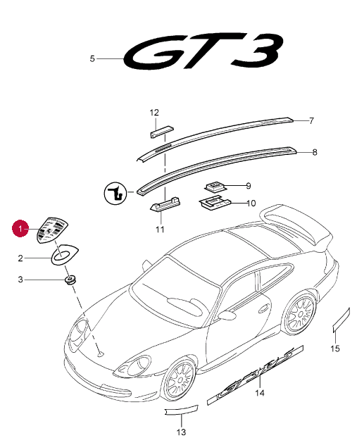

There are two self tapping/locking nuts from the underside of the hood.
It will likely take 3 hands to position the the little rubber insulator when installing a new hood crest.
Also be careful not to over tighten the nuts or they will snap off the posts on the logo.
