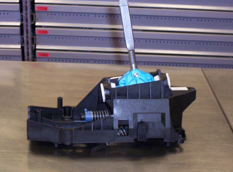

The 997 owner on rennlist said he did not like the feel of the 2nd to 3rd shift. Then he said he did not want a warranty issue. His pictures are on the EagleDay site, and another picture is below.
Another 997 owner on rennlist said he is going to take out the B&M and put in the new style short shift sold by Porsche because he is concerned about the warranty. :rolleyes: Another 997 owner said he bought the new style for $419.95 from Sunset Imports in Oregon. I have looked at the EagleDay site before and their prices are high.
There are 996 owners on the message boards who have put in the B&M, which they liked, just to remove it and put in the identical old style short shift sold by Porsche because of the warranty issue. Loren and I have put in a lot of B&Ms over the years and I have never heard of any issue with the transmission.
