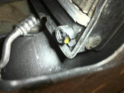

post-28036-0-00032500-1323722203_thumb.jpost-28036-0-57643600-1323722204_thumb.jGentlemen,
My poor new york city dwelling 2002 996 C2 Tip has sprung a leak, seemingly from the plastic part of the center radiator in the attached pictures. Not a ton of fluid leaking but I'd like to get it sorted out.
I'm pretty sure I'm going to replace the center radiator and hoses.
Loren - I know you have a DIY for adding a center rad to a standard trans car. Do you have the part numbers for replacing the radiator and hoses on a Mk2 C2 Tip?
I'd also love to know if the blue rubber seal in the picture is potentially repairable (if it turns out to be the culprit), as anything which spares me from removing the front clip would be nice as I lack a really proper garage where I live.

Yes, those were actual pictures of my 3rd radiator during install - so the drain plug is there. But newer designs might be different.

Based on the photos, my drain plug may have just shaken loose, might be the whole story.
does this part number come up as a drain plug for you? 996 106 901 00 / 10 X 1.5 BEHR

Long story short, it was in fact the drain screw-plug, broken off at the head and slowly leaking. Drilled a pilot, used an easy out, and replaced. Filtered and refilled coolant, pressurized, no leak from elsewhere.
