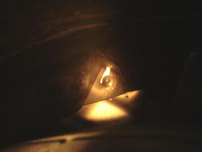

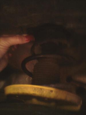

I got this top "bolt" off photo #1 but I still cant get the plastic piece to come off wide enough to get back to the wire. What tool do I need to get these plastic pieces off shown on photo #2-please see next post as it wont let me attach both files. It looks like they could break off easily. Am I doing this correctly is the wire gonna be back there? lol

To get easier access to the pull cable for the hood latch, you can remove as many of those plastic nuts as you can and then pry the plastic back. Even if you can't or don't remove the wheel it does help to jack the car, the wheel will drop somewhat. If you have another car you can use it's jack to jack the car at the jacking point on the frame (don't jack anywhere else, it is covered here under DIY). Once you are in the hood, you can remove the large black plastic cowling near the windshield (two plastic nuts) covering the battery. Then a simple wrench to disconnect the negative lead from the battery.
Those pieces in your picture above just pull out. You can pry the small circular piece against the plastic base underneath. They simply slide straight out. I like to use a door panel tool to do this, but a pair of pliers or even a screwdriver should work.

Thanks for the help. I cant get that plastic piece off for the life of me. I already ripped the round front piece off of it. I went and bought a floor jack and that gave me enough room to get my arm in there feeling around but I cant find the release. I pulled something else out of place that felt like it eas to the headlights or something. I cant get that back in yet. Im pretty discouraged at this point.
Sorry to hear about the trouble. You can safely pry those clips off. Grab from the larger outside plastic piece or pry it out from underneath using the plastic wheel liner as the leverage point. Forget about the thing in the middle. The whole clip will pop out and it will be broken but they cost just a few cents each at an auto parts store or even from Porsche.
Do you own a crow bar? Or a locking pair of pliers? Even the back side of a standard hammer would work. Those would be my best choices at this point, don't be afraid to use some force. Treat it like you are prying out a nail.
If you can get the wheel off that will really help here (maybe your wheel locks and tools are locked in the trunk also). It's not required though. If the car is jacked up a little you can get to all of those plastic rivets and the nuts and the entire wheel liner will come out. There might be a few phillips screws to remove under the liner as well (under car).

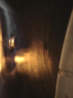

The Porsche tech came to my house and got me squared away and into my car. So grateful for everyones help! He showed me where he grabs the hood release cable and it was so much simpler. I have attached a pic. in case anyone else would like to try there first. I just nw have to find out what exactly I unplugged! Oops.

Yes, the location and type of cable has been reported to be different depending on car and model year.
