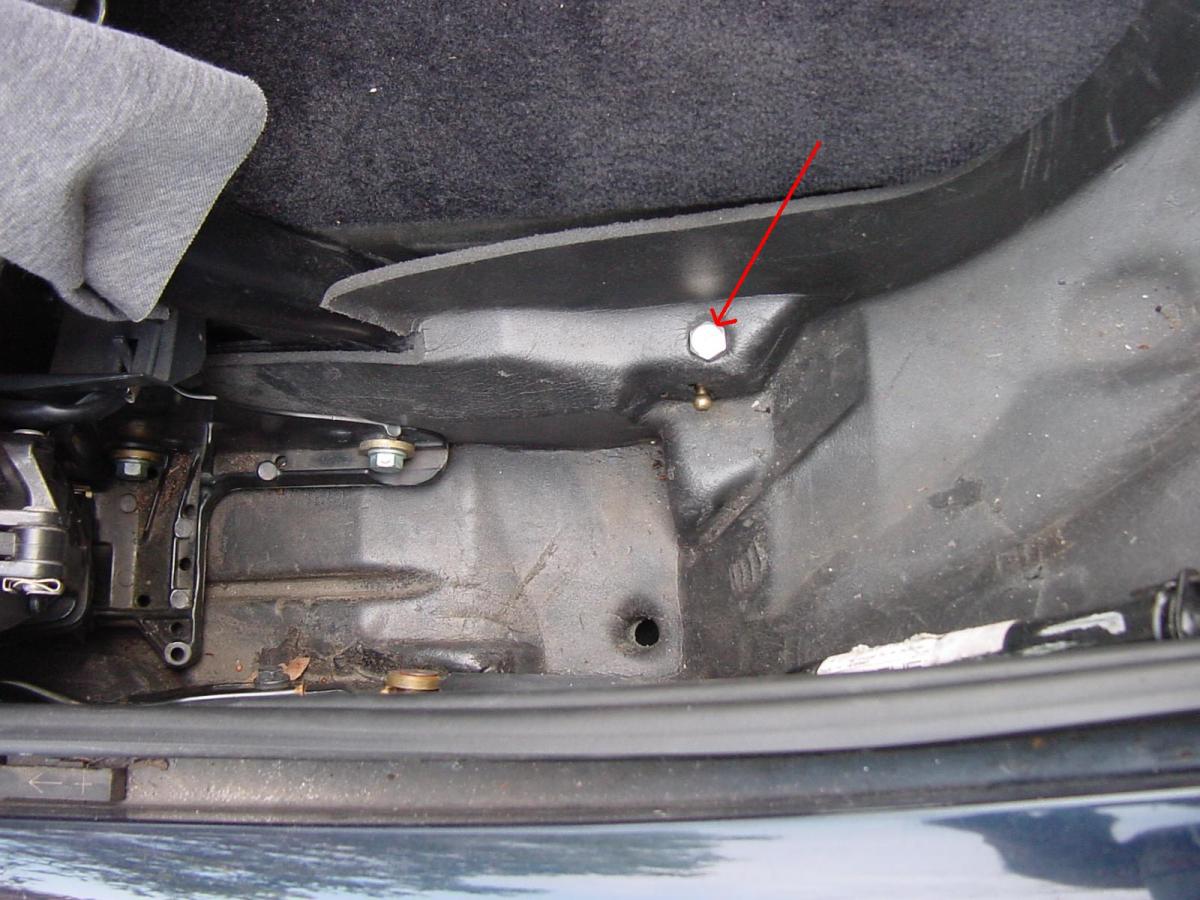

If that's the case, make sure that the tension ropes (cable on each side at the rear of the convertible top frame that pulls down on the rear main bow) are actually connected to their respective steel balls and neither of the tension ropes are frayed or broken. If the tension ropes (which are actually steel cables) are intact, check that they are properly adjusted, and, if necessary, adjust the tension by means of the adjustment bolts. Turning the 14mm bolt counterclockwise will increase the tension and pull the rear main bow of the convertible top frame down. Mark the original position of the bolt on the bolt head so that you can reset it, if necessary and turn each one of the bolts (left and right side) by one full turn each and then check to see what effect that has had on the clamshell when you put the top down.
Here is a photo of the driver's side adjustment bolt. The bolts are located inside the convertible top well, just outboard of the engine cover's rear "corners":
post-6627-0-95138800-1360042969_thumb.jp
