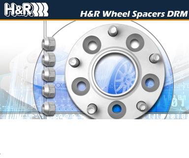

Hi Loren,
I had a major problem today.
Went to put my winter wheels and noticed that the shop that balanced my wheels cross-treaded 2 of the nuts on my rear spacer. I can't get them out. Tried to tighten, un-tighten, wiggle, etc...
Would your method work for me?
Any other suggestions?
Please help.
I attached a pic of the spacer.

Those might be press inserts in the spacers - have you asked H&R about replacements?
Hi Loren,
Not sure I understand you.
Perhaps I was not clear on my question...Two of the nuts that hold the wheels to the spacer seem to be striped, cross-threaded. They turn, turn but will not come out and I need to remove them badly.
I was wondering whether you or any of the other guys following the topic have an idea of how to get those suckers out........
Thank you,
