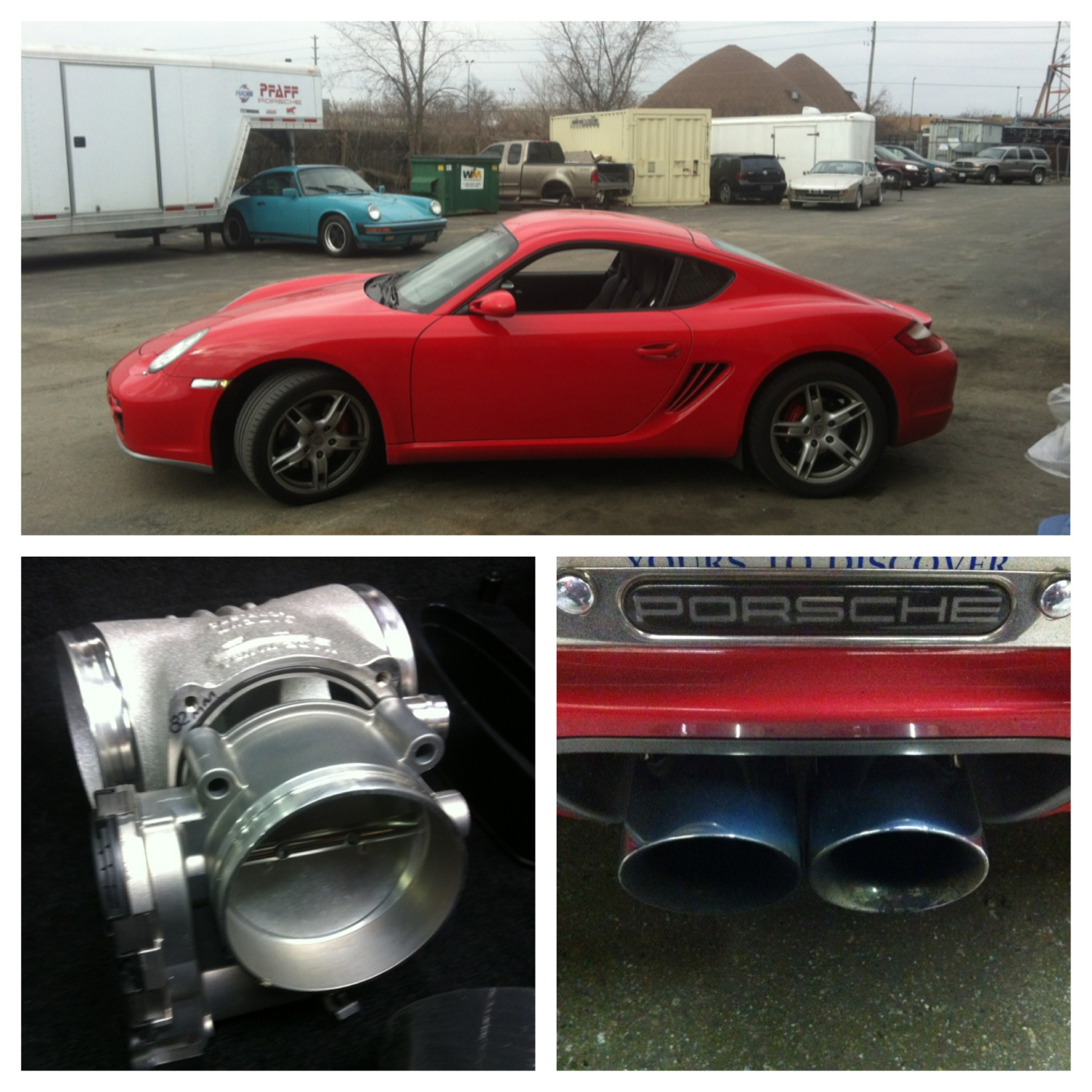

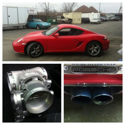

Just wanted to share experience with the IPD plenum upgrade
Cayman S came in with a full fab speed exhaust that we had installed previously for the IPD upgrade.
Fairly easy install and the vehicle definitely feels " more crisp and responsive "
The vehicle came back with a lumpy idle and CEL on with various missfire codes.
Adaption step was missed! Cough cough... Adaptation carried out with an instant improvement and smooth idle. Remember to always adapt a TB when replacing it as mentioned by Loren in a variety of posts.
Adaption
Key on 1 min
Key off 10 sec
Check and erase faults.
