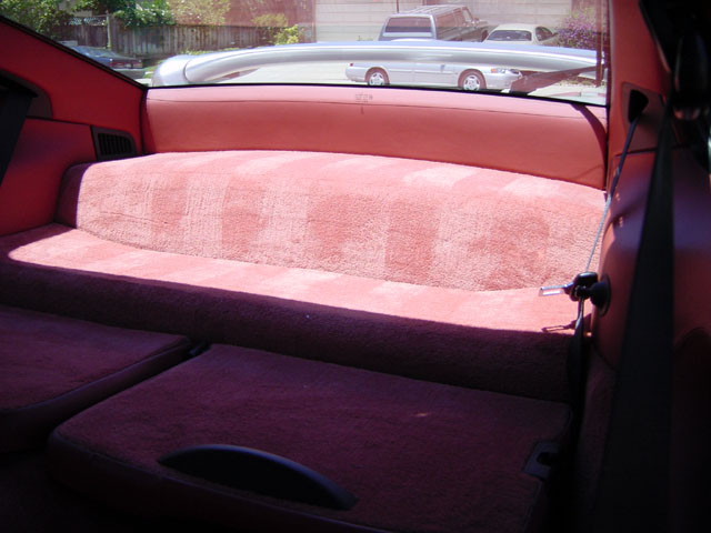

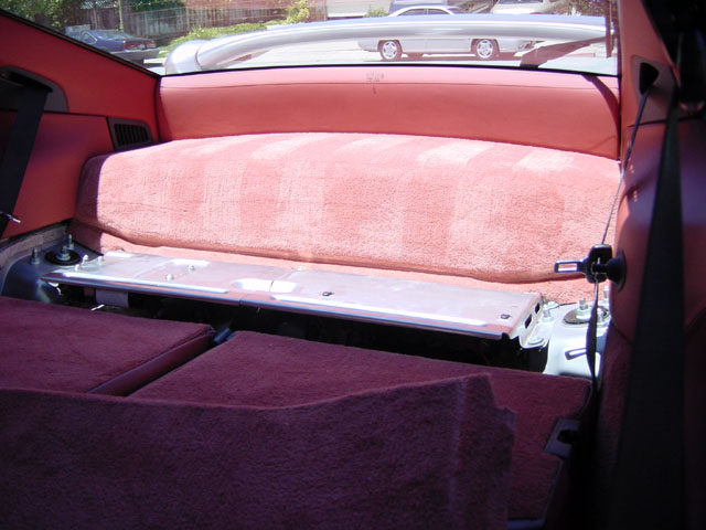

The relay is on the relay/DME panel under the carpet behind the rear seats.
You will need to loosen the nuts and turn the panel over to access them.
