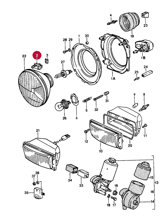

I have been looking for the #6 part on the diagram 905-00 from http://dcauto.gotdns.com/illustration/index/966143504
So far no success, I am also seeking the left and right headlight lenses as both mine have cracks in them.
My current project is an '88 Euro 944 Turbo from Japan. Yes it is LHD!
Part # from the actual head lamp is: 944.631.101.09, 944.631.101.10 - H4 Hellas
Any info as to finding these parts will be greatly appreciated!
Terry
Good snag on the diagram!
Part "1a" has plastic connectors on the end of the round head bolts that surrond the bolt head and clip into the headlight frame. I am looking for the lens and these plastic connectors. Both left and right.
My parts list says that whole frame is 944-631-907-00 and that is has a US MSRP of $26.35 each.
Separate parts for it are not shown as available.
Headlight lens (for left hand traffic) is 944-631-911-00 and they are US MSRP of $140.89 each
