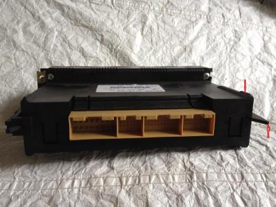

Dharn55, It was hitting some stepped shelf in the top of the bay. I am really not sure why the shelf was stepped. It started about 4 inches back or so. I was amazed at all the angles and steps and modified brackets and one type of screw mount and another type of screw mount I found through out the upper and lower bay.
Here is a pic showing what I had to remove with my dremo drill. The down pointing arrow shows a raised edge that I shaved off down but not including the lower longer raised edge. SO I took off about an inch of this edge. The upword pointing arrow shows the tip before I knicked off the very point of this angled edge.
post-80079-0-73395500-1336413176_thumb.j
Edited by barlowdo
