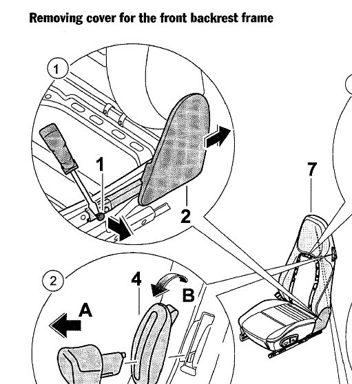

I have two new seat caps (part number G99652131501A03) I wanted to install.

MAny thanks... but I am not sure how to get at that rivot with the leather seat in the way.....
Guess I should have been more specific.
How do I expose the rivot in shown in "1"?
Thanks for all,
dday
If you can not get to it from the bottom then the seat cushion will need to come out (requiring replacement of the plastic tabs that hold it in place).
Don't forget to disconnect the battery when working on seats or removing them from the car so you do not get an airbag light.
Thanks, will see if I can get at it from the bottom...
If not, what is the position of the plastic clips and do I need to remove the seat the get at them?
