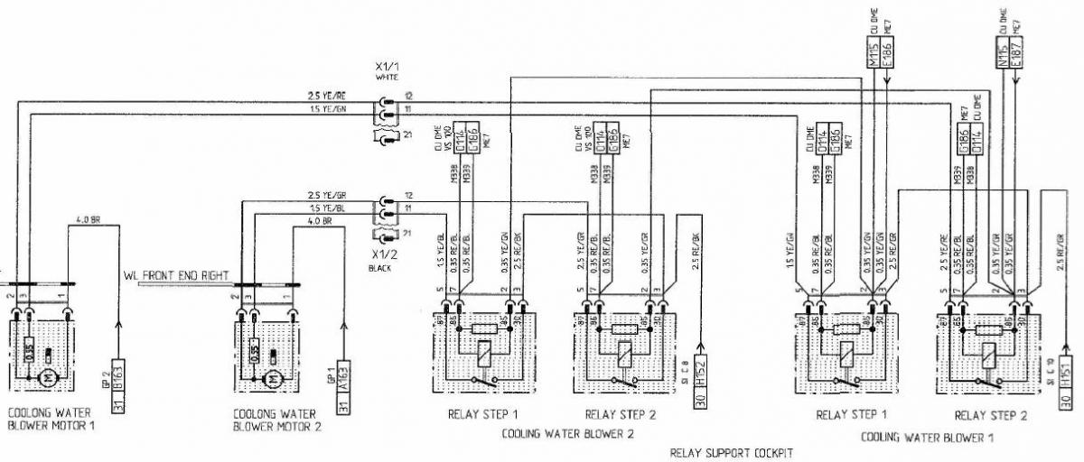

High speed fans not working, low speed work ok
My 99 C2 Cab has begun to overheat slight (right hand of 180) on hot days. I've checked all the threads and can confirm:
- low speed fans come on when AC is pressed
- fuses (row C 8 and 10) both fine (I don't think the low speeds would work either in this case)
- durametric can drive the low speed fans
- durametric "RPM stage 2" which is right under low speed fans (I believe high speed fans) does nothing
- I've removed both the low speed relays and the high speed fans do not pulse on and off as they should do.
- If I feel the high speed relays with the low speed relays out, I don't feel any clicking
So it seems that the relays of the high speed fans aren't getting energised. What else can I test to narrow it down?
