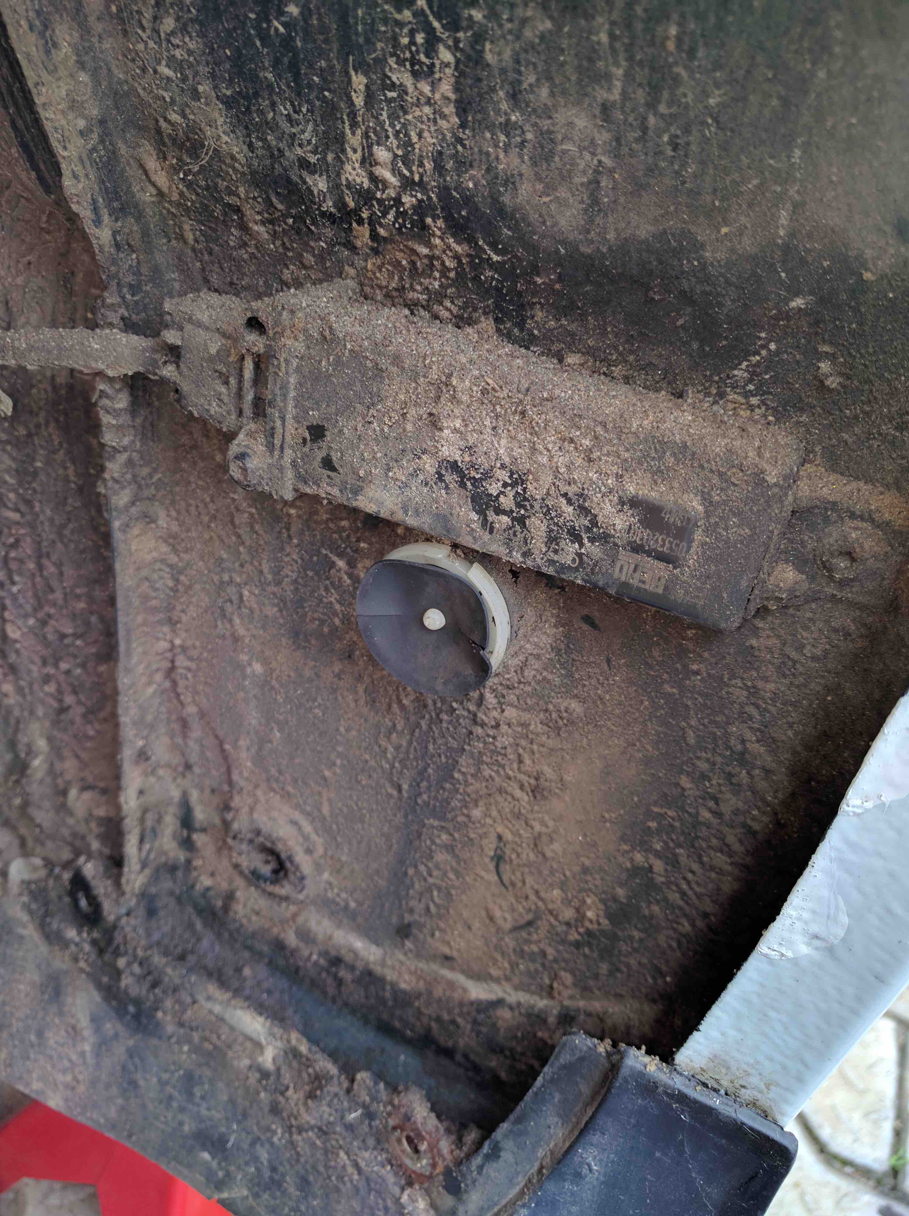

Several years on and this remains a very real damage threat. I was literally scooping out water in the rear foot well any time the car was washed or there was a slight downpour. Even with the car covered the water would still find is way in there somehow. So I removed the rear wheels and the plastic lining under the rear wheel arches, I couldn't believe how much dirt was in there, the drains were totally blocked! I pulled it out and cleaned it up and there has been storms with the car uncovered and not a single drop inside.
It would be a good idea to check this at least once a year, it's a very small drain for what clearly is a major drainage. See the cleaned out plastic drain with a flexible rubber cover below...

This is great, thanks but I"m disoriented as to what I'm looking at. Can you zoom out a bit for more context?
Is that some type of control module in the wheel well? Seriously?

This should give a clearer picture, I have no idea what the control module is for
