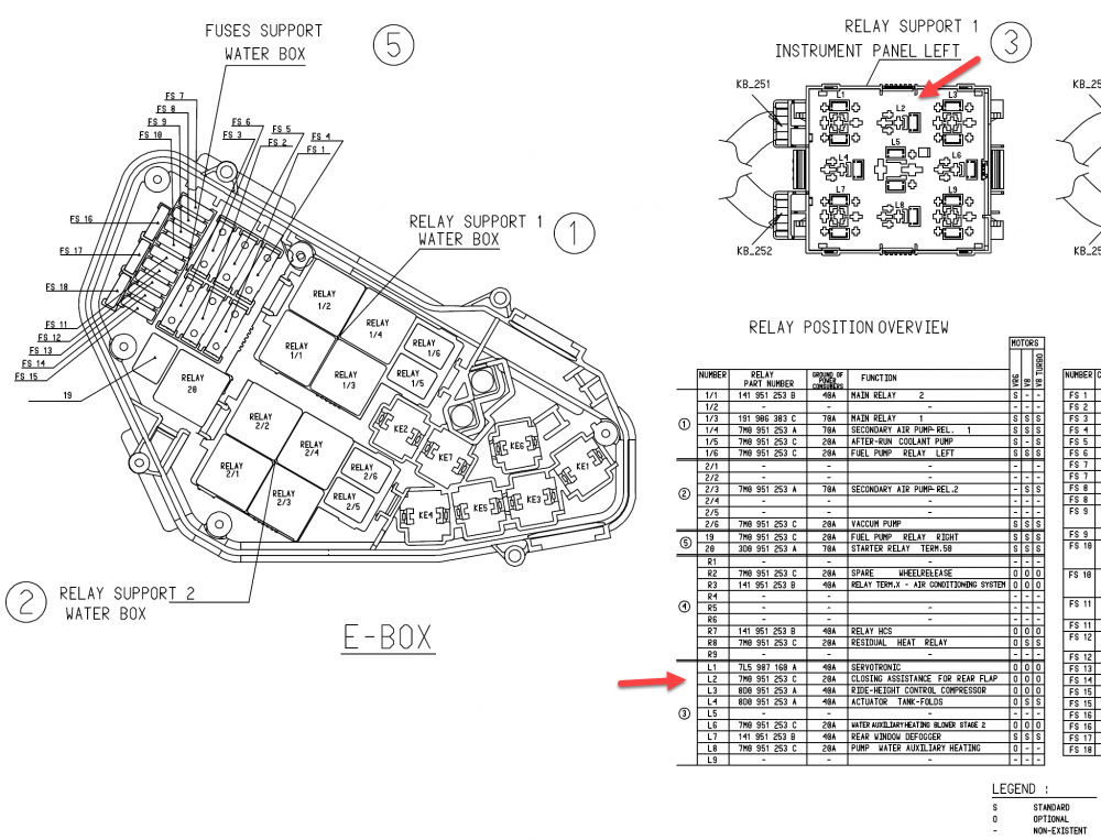

On 10/2/2012 at 9:19 PM, Loren said:
I checked your VIN and you have that option.
Check fuse F30 and the relay L2.
Relay L2 = ? Left side fuse box? I can't find that relay on the schema.
I have issues with the closing mechanism on my Cayenne. It stopped working intermittently and when I now press the closing button nothing happens. The button has a light though, and no error codes. Fuse 30 seems fine but fuse 31 I have not checked, nor any relays. I don't understand L2 refers to.
