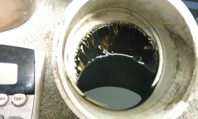

First, I had a clogged fuel filter that my wife so easily diagnosed

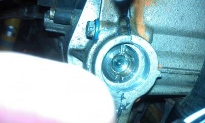

second, installed variocam plunger upside down on bank 2.
