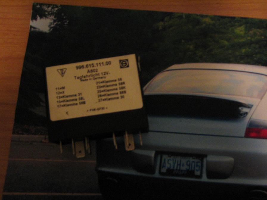

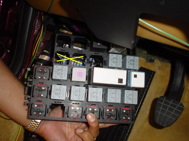

Schematic says "double relay" - relay in position 6 and 7. That would be second row from the top, first 2 relays from the left. Both should have part number 996 615 111 00. I do not know what happens if you pull them. Let us know.
The relay is a double sized relay, like the top relay. Where the yellow X is.
On the PCA tech site it says just to remove the relay. I have in the back of my memory that someone on the internet said other lights, like for the license plate, may not work.
So pull the relay and let us know if all the other lights still work.
