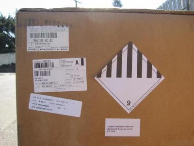

This is 2 pictures of boxes the engines come in. The first is 986 100 924 FX for a 3.2 manual transmission. Letter X at the end of the part number mean it is a rebuilt.
The second is the engine that went into my friend Jean's car. The number is 986 100 922 03. The last 2 digits are numbers, not letters, so Jean's replacement engine was new. Like you Jean had the seal replace 4 times on his 2000 and then Porsche ultimatelly put in a new engine.
Jean was a unique case. After 4 leaky seals Porsche put in 3 rebuilt engines and each of the rebuilts had a vibration problem. Then Porsche ageed to put in a new engine and that is the one in the second picture.
Is their a part number on your invoice? Most likely it will be a rebuilt, due to the age of your car.
