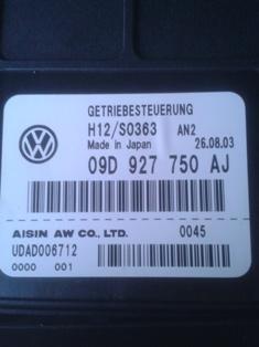

I'm dealing with hard 1-2 upshift. I was researching a lot and looks like that is the only option to replace TCM unit.
My TCM 955.618.022.03 has sw S0363, which means that has to be replaced wit newer TCM.
So I was looking this TSB:
http://www.renntech.org/forums/index.php?app=downloads&module=display&section=download&do=confirm_download&id=711
According to this TSB I have to replace my TCM with 955.618.022.AX which have SW version 0600.
According to this TSB I also figure out, that I don't need DME update, but just TCM replace.

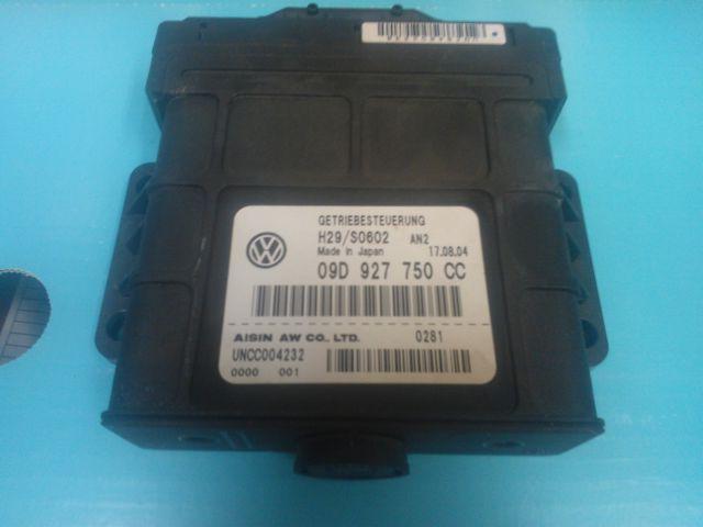

So my question is, is there any chance that TCM 955.618.022.12, with SW 0602 wil work in my car?
I have option to get this TCM at weary reasonable price, but I don't know if it will work, or what could be a difference.
Thank you for any help.
