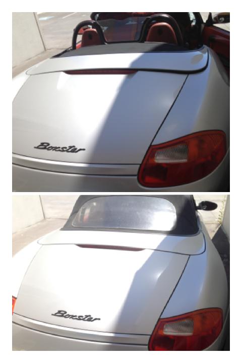

[HELP!] Boxster Roof Issue!
First check to make sure that there are no foreign objects obstructing the frame of the folded down roof.
Next, disconnect the front pushrod and the rear pushrod on that side and see if you can press the convertible top frame and clamshell down to the proper position (when the top is folded down). If it does press down into the proper position, you will have to re-synchronize the V-levers by operating the passenger side (right side) drive cable with a cordless drill so that both sides of the clamshell close equally.
Sometimes it's a matter of balancing the position of the left and right sides of the clamshell so that you get the best overall result on the clamshell whether the top is up or down.
