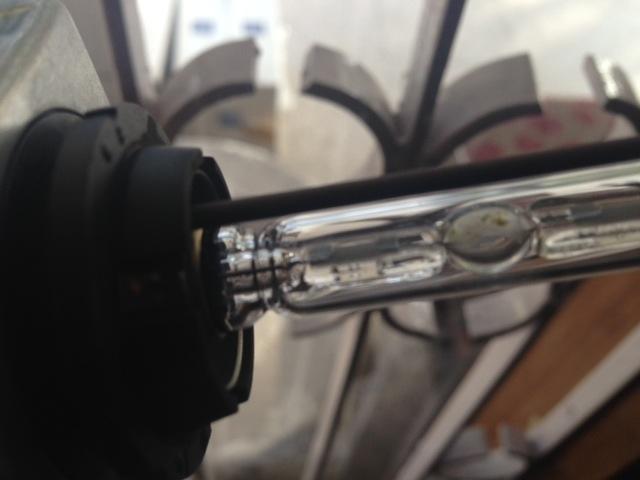

I was having some trouble with my Cayenne 2006 headlamps. It has a bixenon setup, the light was too dim.I took out the D1S bulbs and found that the bulbs were a little hazy with a dark brown discoloration around the middle. They are Osram Xenarc 35WPicture1 is of the bulb with the discolorationAlso I had some aiming issues with the head lamp. I found 2 adjustment screws, so my question is that is it possible to adjust the high beam and low beam seperately?I thought there was only one screw we turned to adjust our headlamps.Also I found a shutter inside the xenon projector housing which i pressed with a screw driver and it flipped down? What is this for? does it mean when we switch on the high beam the xenon shutter also falls? If so then why do we have a seperate high beam on the side?
