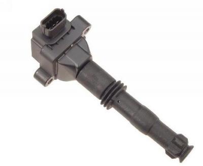

Should I replace them when I replace the spark plugs - or wing it? I was going to order at least two in case any where bad when I jumped in to it, but is it better to just go ahead and do all six?

Look for cracks or damage but the best test is with an ohm meter.
Resistance between terminal 1 and terminal 15 at 20° C should be 0.3 - 0.7 ohms. If not, replace the coil pack.

I do have an ohm meter... is terminal 1 on the coil and terminal 15 on the engine? (not sure where to put the red and black tester wires)

If you take the coil off the car and look at the electrical connector you will see 3 pins. The pins are labeled 1,2,3.
You put your ohm on pin 1 and pin 3 (terminal15) and measure the resistance.
