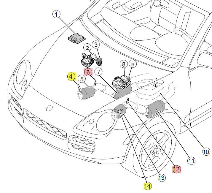

V8 only...
4 and 14 are pre-cat O2 sensors - bank 1 and bank 2 respectively
6 and 12 are after cat sensors - bank 1 and bank 2 respectively
