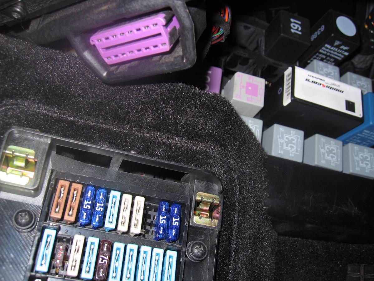

Here is a photo of the double relay and its location. If your double relay has a black square on top, it's the "B Version" transmissions and set -up. If your double relay has a black triangle on top, you have the "A Version" transmissions.
post-6627-0-77833600-1370560018_thumb.jp
Also check these two fuses (B6 and D3):
post-6627-0-35769300-1370559540_thumb.jp
