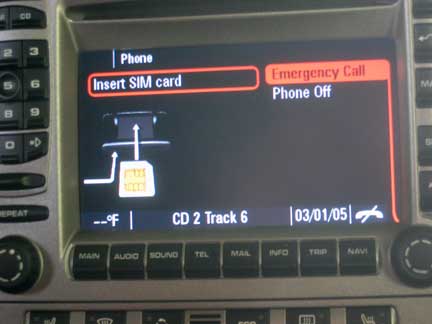

The GSM phone is very well engineered and hands free is the way to go. You must have a PCM that has the Sim card drawer ans SOS button to add this option. (early prod cars did not have this faceplate)
p/n 997 044 900 71 Telephone Module PCM2

Thanks for the info. The car has the little SIM drawer, and lots of buttons, including SOS. I'll check with my dealer's service manager when he gets back from Hawaii. Glad to hear the Nav is good. So many of the cars we looked at (e.g., BMW) has really bad systems.
Is there any way to use her current phone (Cingular GSM) with the Telephone PCM2 module, or will I need to get another SIM with a different phone number? Would I be better of with a Bluetooth phone and figure out how to make that talk to the PCM2 system, so 1 phone does it all? I haven't seen the PCM2 in action with the phone setup, and my salesman wasn't up on all the details.
They have done a very good job with the implementation of the GSM phone module, sound quality is great in both directions.

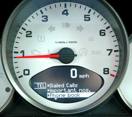

She can use her exhisting SIM from her current phone, just take the card out of the phone and pop it in the drawer, bit of a pain since we can't get dupe cards, but after you do it a few times it's an easy task. Coolness is that the stored numbers come across as well, and appear and can be scrolled thru and seen in the OBC window under the tach.
