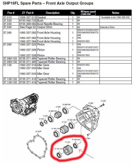

In the middle of rebuilding a 2000 Boxster Tiptronic transmission, ZFHP19FL and I am having difficulty finding a part. I have the ZF p/n as 0735 371 418 and it is a tapered roller bearing in the front axle output on the intermediate gear. I have called ZF and the local Porsche dealer and they are unable to cross-reference the ZF number to a Porsche part number. I have also looked at the Boxster parts catalog and I have been unable to locate the part in their diagrams. So I'm hoping someone can help me here.
post-28317-0-28487700-1376669498_thumb.j
Thanks for any help you can provide!
Side note: incredible how unhelpful both ZF and their distributors are!
I found an obscure reference to a Timken p/n LM48548 which is a tapered bearing dimensions 34.925x65.088x18.034mm. These are easy to find and readily available so I ordered one (with the race p/n LM48510). I am still not 100% sure this is correct but it was cheap so I'll give it a shot. I still have not been able to find a Porsche p/n for this, so if anyone figures this out please let me know. Thanks!
