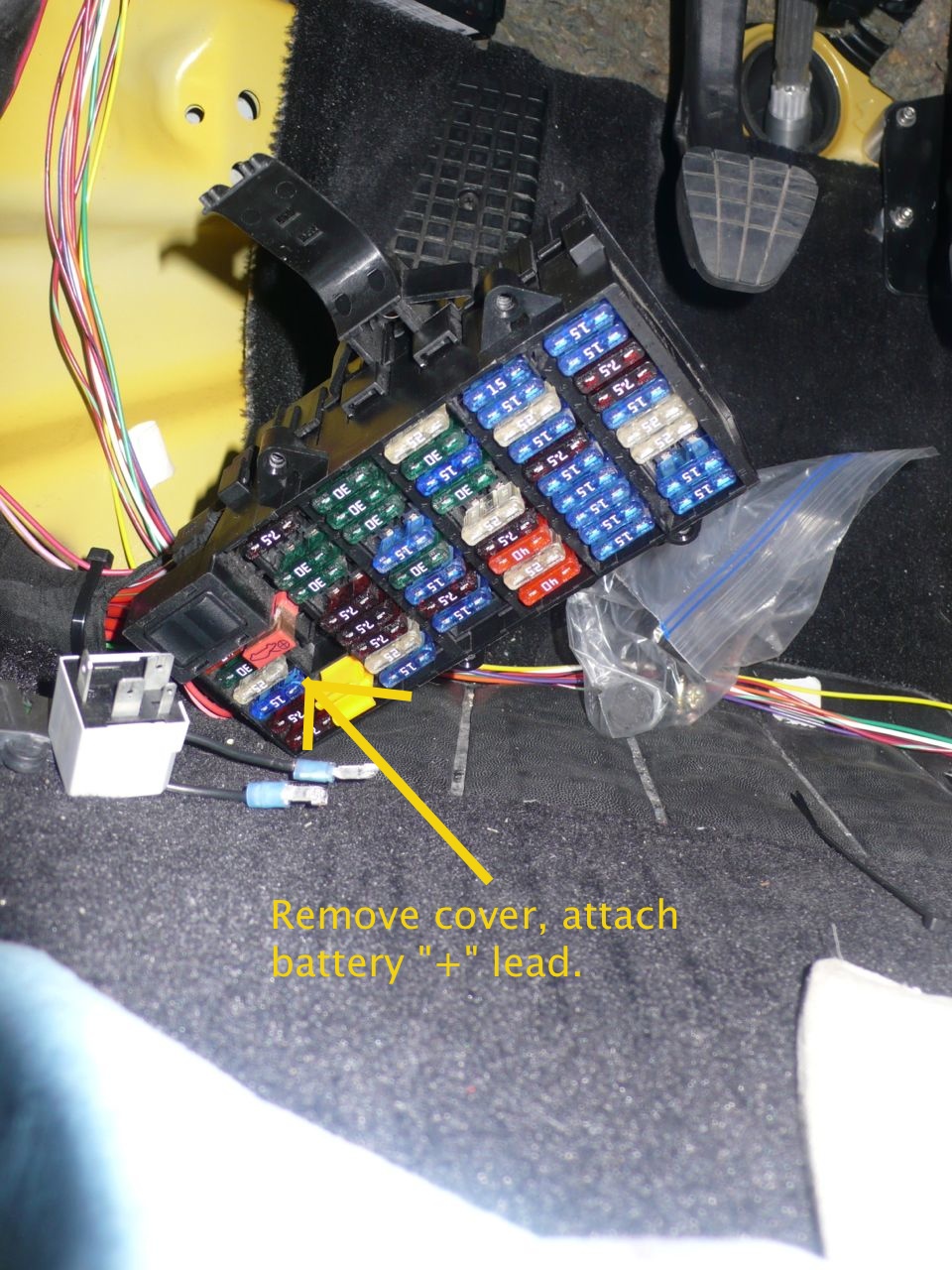

What I didn't know is that you can do a battery jump off of the fuse/relay panel on the left footwell. The information is in our Owner's Manual. My question is, can
you also use a battery charger in lieu of the battery?

See page 214 in your Owner's Manual...

Depends what type of charger you are using. A power pack will do it but a little trickle charger will not. Not enough current to trigger the solenoid. I have a little motorcycle battery that works great. I was working on the car once with the battery disconnected and I inadvertently closed the trunk.
