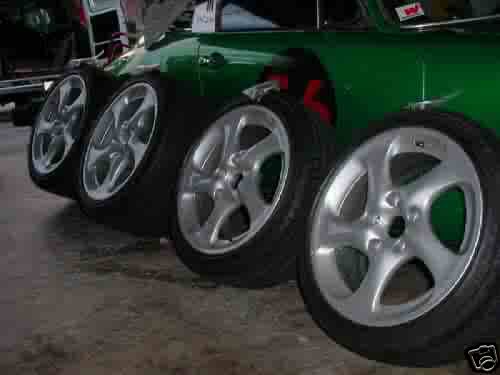

Has anyone put this size 295/30/18 on their 1999 C2?
Do they look right, the TSB says they are approced but holy cow, they look a little wide.

Lesson learned, stuck them on, sticks out an inch, looks rediculous. Anyone need a brand new set of Turbo 2's?
I will be looking to fix this, this week. Loren was right at the tire it is 12inch wide apply that to that on the car, it will function fine, no clearance issues at all, its the overall look that lets you down.
