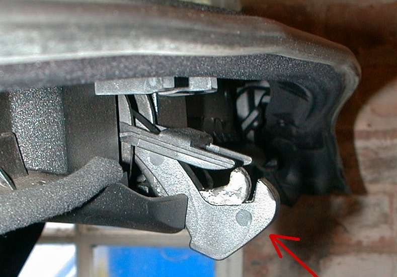

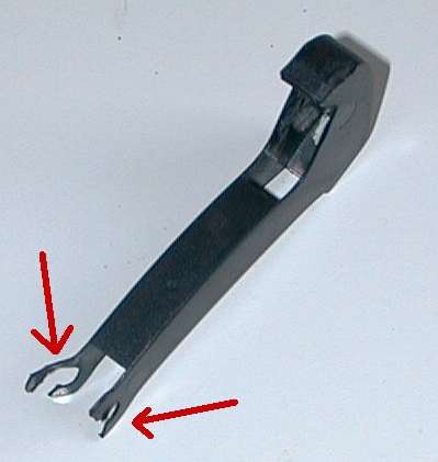

My bet is the platstic hook has broken off the hook that attaches to the screen.
All you need to do is glue it back on with some contact adhesive and all will be fine. The arrow in the 2nd pic shows where it breaks. Don;t worry about this, just glue it back on without taking the whole unit apart. Simply just pull it off. The 1st pic shows the plastic hook part separated from the metal hook part it covers. Once glued back all will be fine again.
You need to clean the metal hook and its shaft with white spirits first. Then put a very fine layer of contact adhesive on the hoook sides (as far as you can) and top of the hook. Clean the inside of the hook with spirits and also smear a very thin layer of contact glue on the inside of the plastic hook cover.
Let the glue touch dry then push them together. Job done.
IMPORTANT: make sure the glue you use does not melt the plastic cover. Best to test a tiny area on the inside of the plastic hook first.

It was just the right side of the tip by the hook that was cracked...the damage in your picutres by the arrows were not a problem (i.e., they were not broken). I needed an oil change anyway, so they are going to let me know what the problem might be without charge. I'll fill you in tomorrow.
