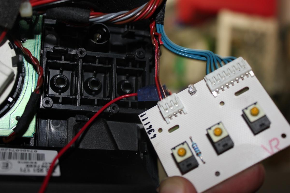

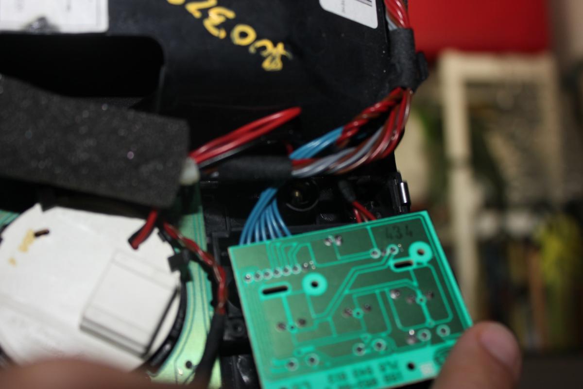

Actually I got impatient and figured out where the main power wire was on the 3-pin connector that goes to the buttons. I ran the same key-on power that I have my V1 radar detector on and it works fine. I did cut the wire. The instructions look to be a cleaner way to do it. The thing with the TSB is that on the 2004 like mine, it will get power to the switches by pressing on the brake pedal (when the CAN circuit power to modules comes on). If it took the key-on I'd feel safer on the nights my car has to sit outside. It'd be easy for someone to smash a window and then manage to operate the door opener. Maybe I'm just paranoid :eek: . I took pics and will post later on where I made the splice.
