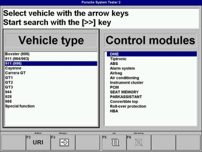

Trying to change the VERSION (coding) of the automatic door lock under the Alarm module with PST2, when selecting CODING under such module I'm getting Function can only be performed after automatic search, I changed the version from 4 to 2 some time ago and did not get that message. Do have the alarm horn disconnected since is no good. Could that be the reason?

So, most likely is because the alarm horn is not connected. Can I use this horn (see pic)? Is 12 volts disk horn similar to the factory one.
As it says, you need to do a full control module search before you can change the version coding in the alarm module. In other words, from the Vehicle Selection screen, choose 996 and press F12 to search all the modules first - do not just tab across to the alarm module.
