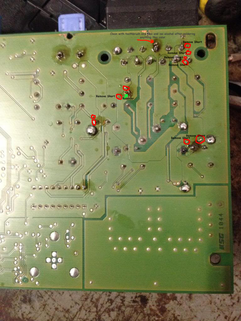

The noises are definitely coming from the control unit under the seat. I have just pulled it apart and had to shake my head when I saw the circuit card - yet more "repairs" the PO attempted in a shade tree way. See picture

Hello to the forum members and Shelby427uk. The soldering on this PCB board has some short circuits on it and it is - new soldering. Also remove flux (The brown stuff left after soldering) with a toothbrush and some iso alcohol so the pcb is clean. See attached image.
All the best.
