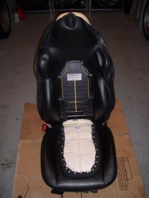

Before you start you need to take the seats out of the car. Be careful, I managed to gouge the trim on my passenger sill so put down padding and make sure it is secure: mine wasn't and it dragged the cover off. It is much easier to get someone to help you remove the seat and even then you will need to take it slow.
First take off the central leather section (it is held on a wire by the three white clips at the top -- lift up and then out to remove).

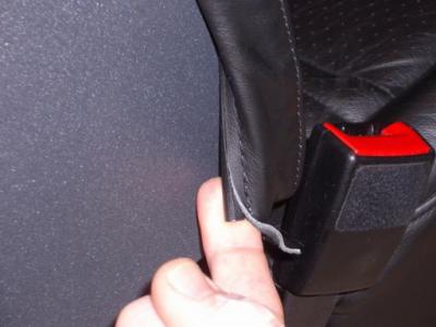

As you can see in the photo above the outer leather stole is already partially removed. You do this by locating the tags at the bottom of the rim of the seat at either side and pulling these out and upwards. Do this as gently as you can but it may require a little encouragement.

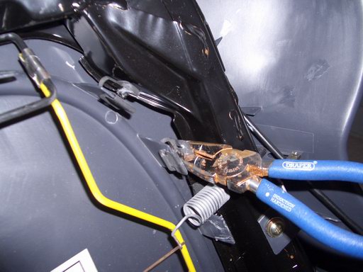

To remove the outer leather stole completely you now need to unhook it at the bottom -- IIRC there are three grey metal hooks and also unhook all the grey metal clips that keep it secured in the centre. The picture below shows one of the clips that has come adrift from the leather stole. Try to keep them all on the stole, and in the same position, as it helps with putting it back on later. It's a bit of a pain getting these off as they are quite tight and move around when you wrestle with them.
PS That set of pliers has been retired.

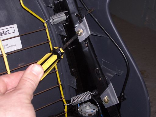

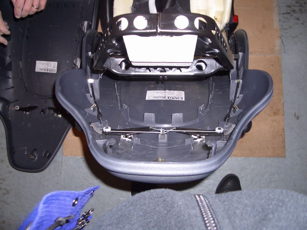

Next, undo the cabling. DO NOT break the small grey tab in the centre that both the cables pass through. A new seat back will cost you £380 (probably $600, although things seem to be cheaper your side of the pond -- if anyone can give me a price I'd be interested).
Note when you put this back together that the top of the black wire holders actually fit into the grey U sections at the top of the seat (the ones above where the metal clips have partially popped out). The black cable popped out as the seat back was tilted away from the frame.
